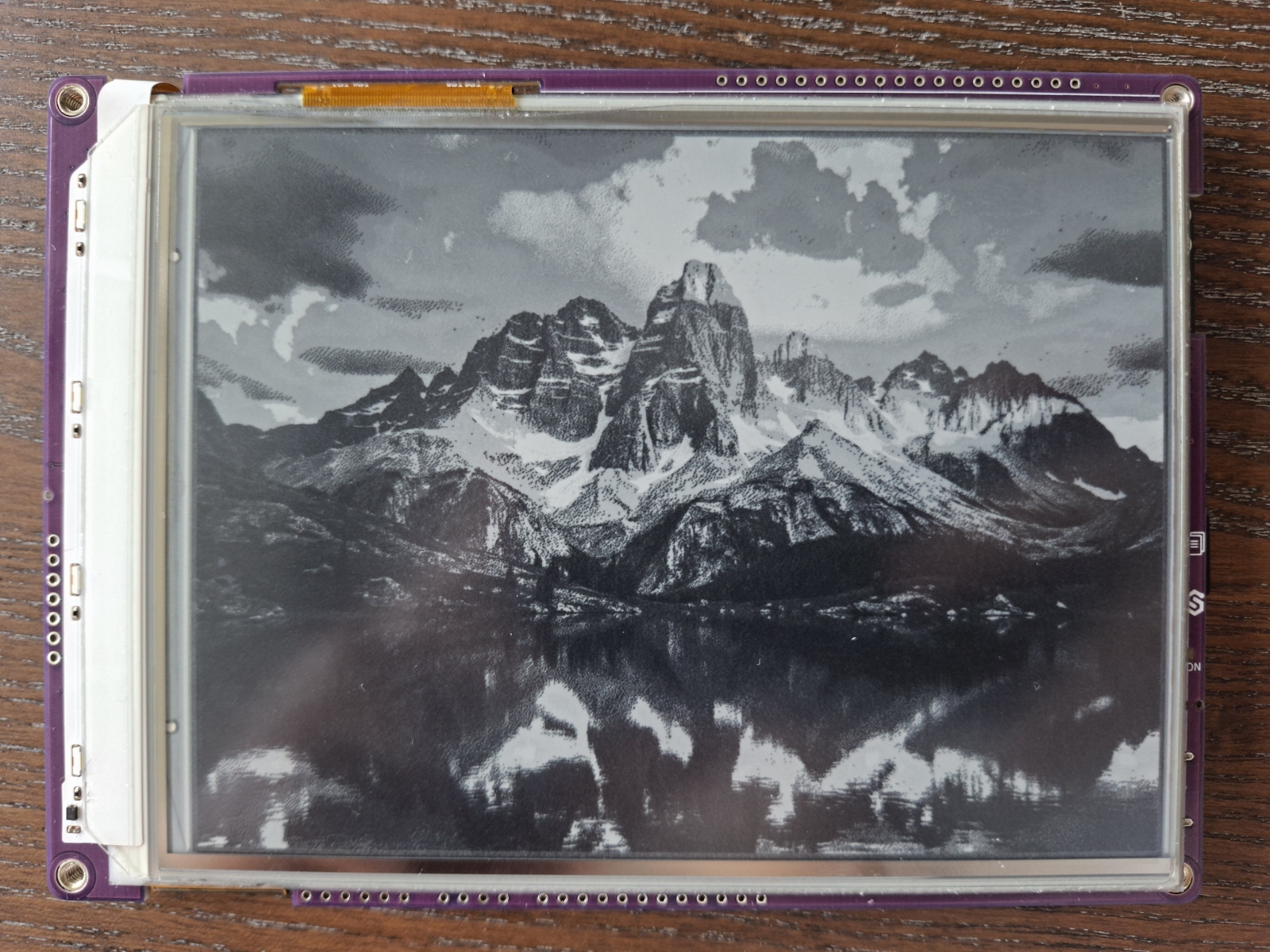

Inkplate 6FLICK running the example code
Displaying an image from web.
