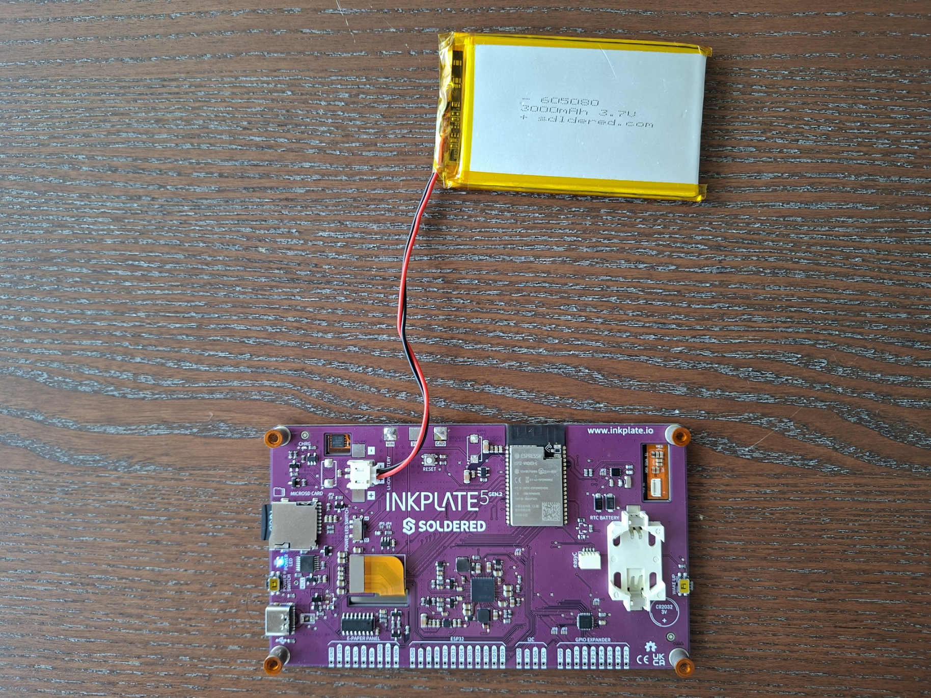

You need a Li-ion battery for this example to work. For more details, see the battery docs page.
Connect the battery like this:
Inkplate 5v2 running the example code
Battery connected to Inkplate 5v2.

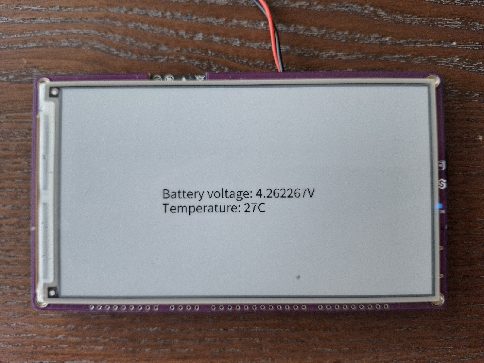

Displaying battery and temperature data on Inkplate display.
