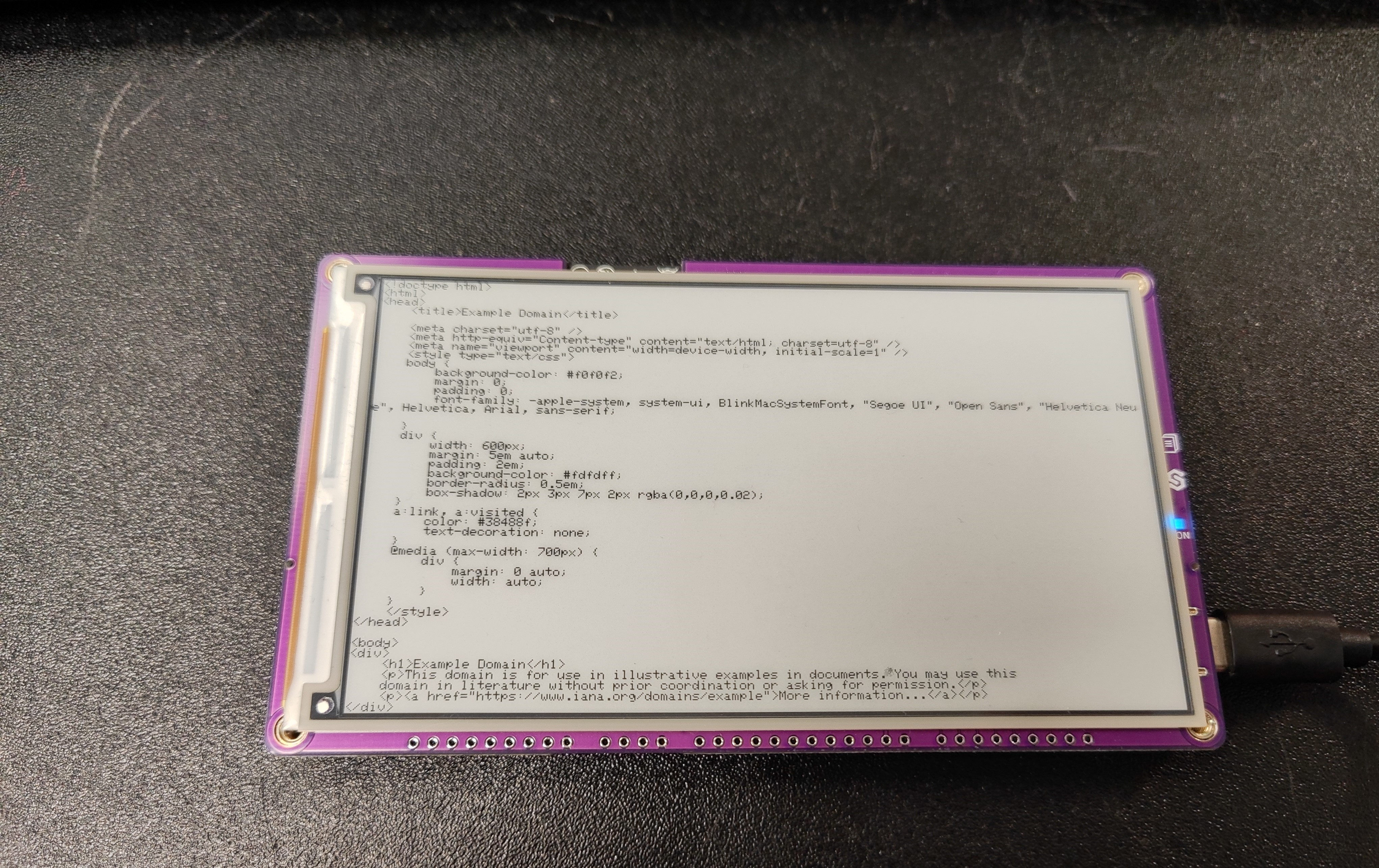

With http.GET() you can download data and handle it on Inkplate however you want. Here's an example that GETs a .html file and prints it on Inkplate:

HTTPClient http;
if (http.begin("http://example.com/index.html"))
{ // Now try to connect to some web page (in this example www.example.com. And yes, this is a valid web page :))
if (http.GET() > 0)
{ // If the connection was successful, try to read content of the web page and print it on screen
String htmlText;
htmlText = http.getString();
inkplate.clearDisplay();
inkplate.setCursor(0, 0);
inkplate.print(htmlText);
inkplate.display();
