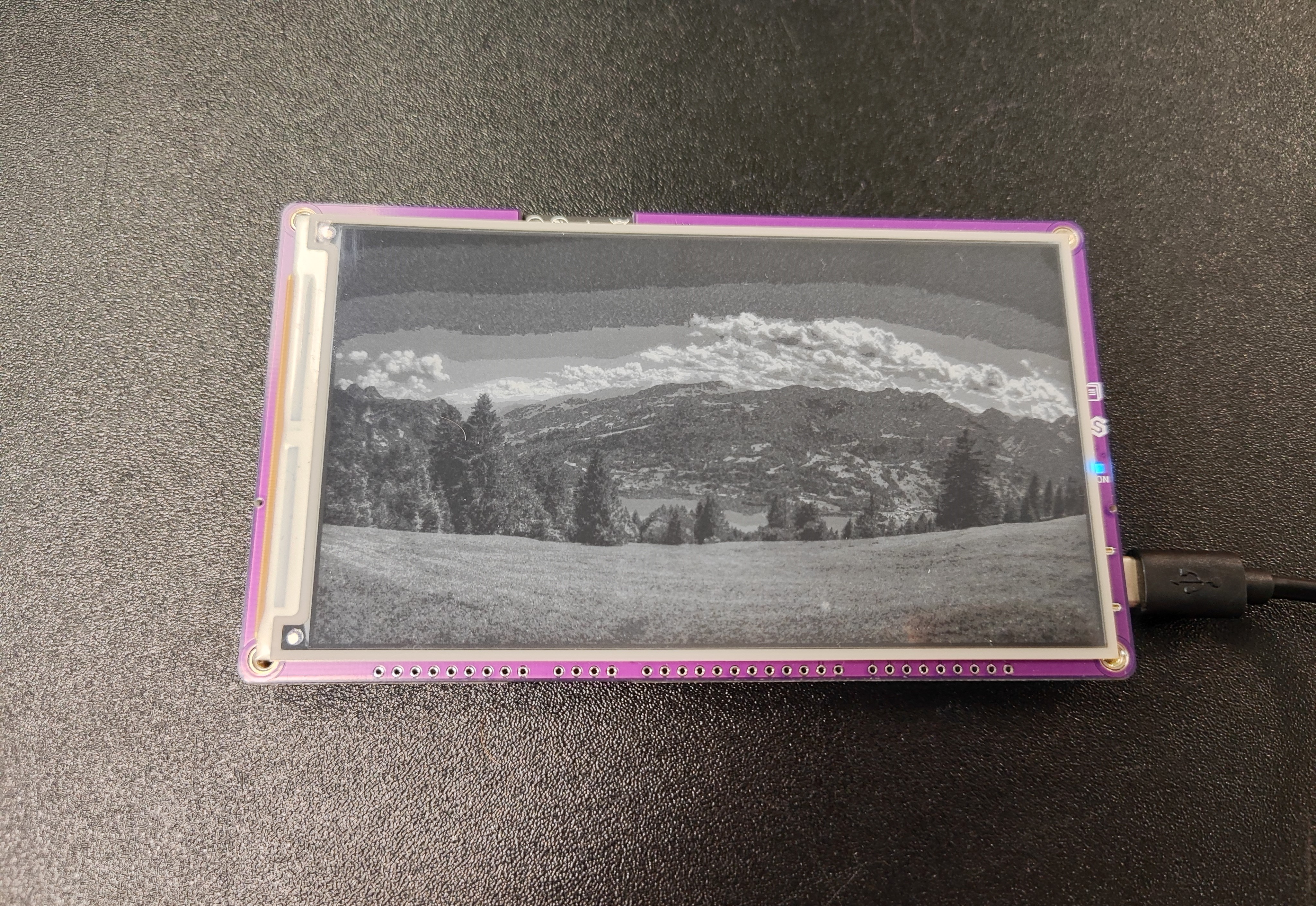

Let's draw this image on Inkplate 5V2:
Example Image
Example image by @alexisg on Wallpaper Safari

Example Image
Example image
