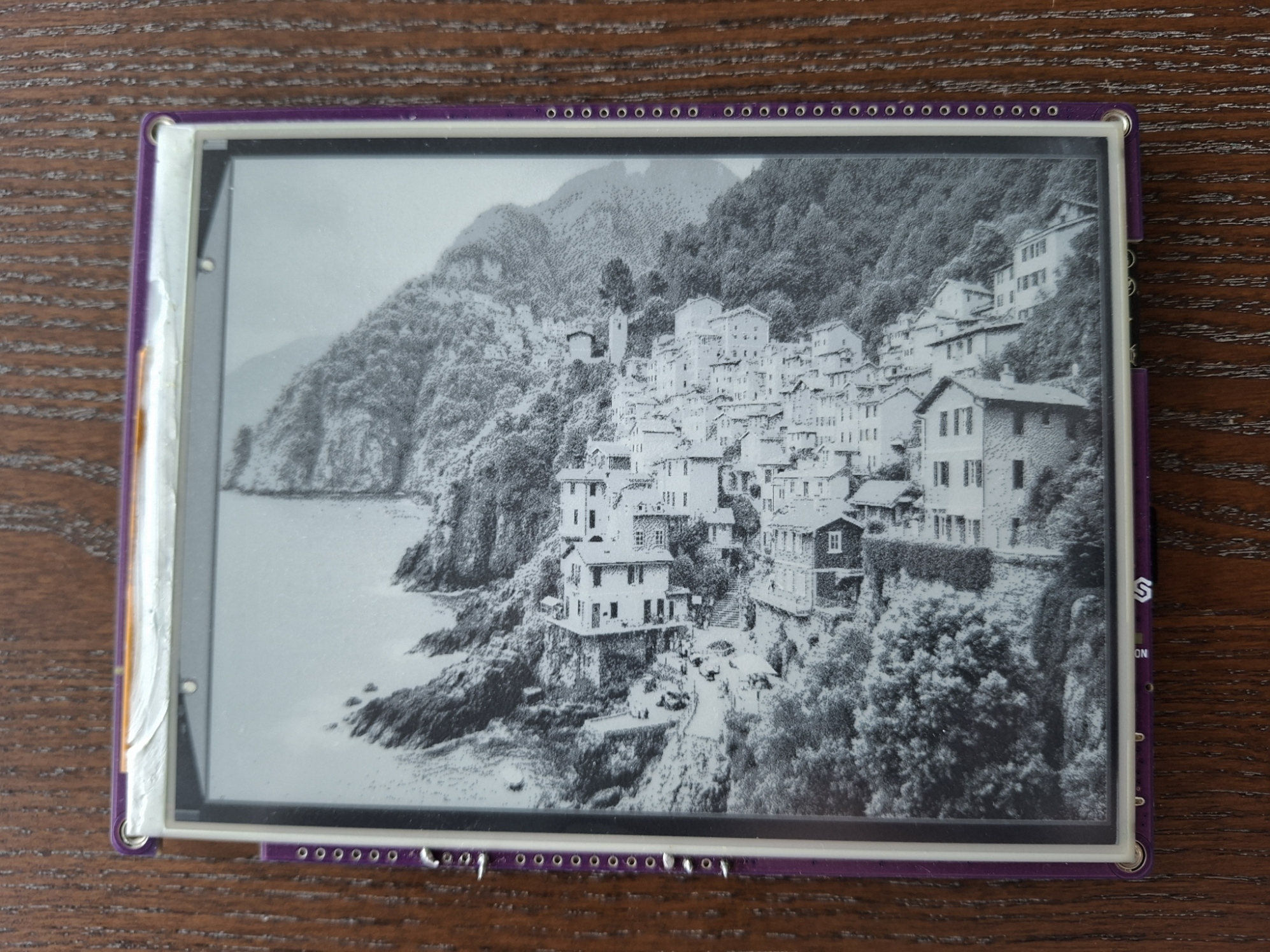

Displaying an image from SD card.
Full example
display_image_sd.py
Initializes the microSD card, lists its contents and renders an image from it with dithering.
