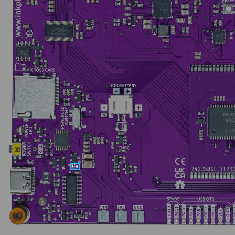

The Inkplate 6MOTION can be configured to power on automatically when current is present, bypassing the power switch.
To bypass the power switch, simply short the R24 pads by directly adding a small amount of solder, or soldering a 0 Ω resistor. The location of these pads is shown below:
R24 connection highlighted
