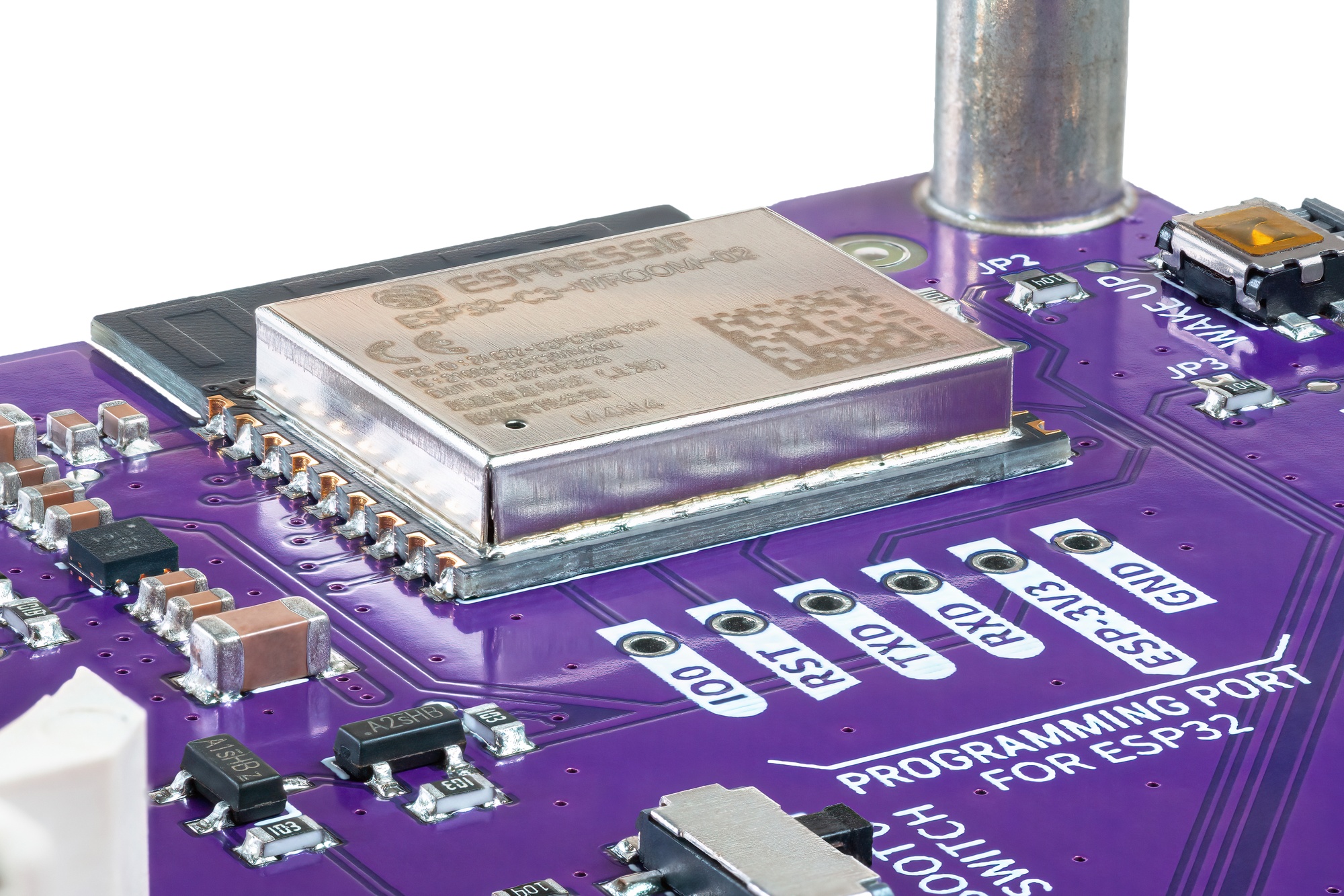

Inkplate 6MOTION features an ESP32-C3-WROOM-02 module, which serves as a WiFi co-processor. It communicates with the STM32 via SPI, using AT commands to handle network operations.
In our documentation and code, you may sometimes see the ESP32 co-processor referred to as the ESP32 modem, as it functions similarly to traditional modems by processing network-related tasks.
ESP32-C3 on Inkplate 6MOTION
ESP32-C3 co-processor on Inkplate 6MOTION
ESP-AT firmware​
Overwriting the ESP32 firmware that comes pre-installed on Inkplate 6MOTION will disable WiFi functionality!
The ESP32-C3 runs ESP-AT, an official firmware by Espressif that enables the ESP32 to act as a co-processor controlled via AT commands. This setup allows the STM32 to request the ESP32 to connect to WiFi, download files, and transmit data over SPI.
