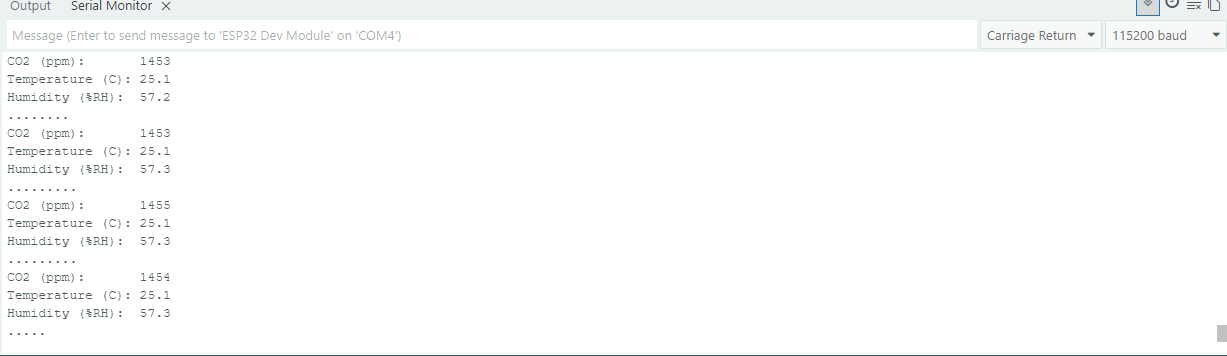

Serial Monitor output​
SCD43 Serial Monitor output
SCD43 Serial Monitor output showing CO2, temperature, and humidity readings
