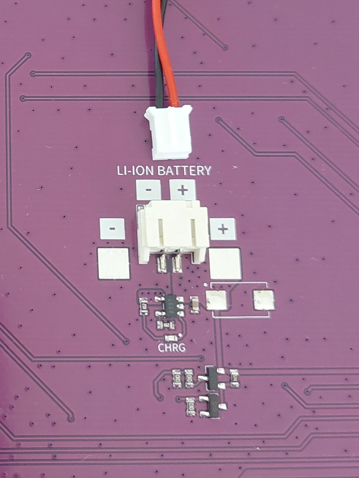

Connect the battery to the board like this:
Li-ion battery connected to Inkplate 13SPECTRA
Battery connected to the board
