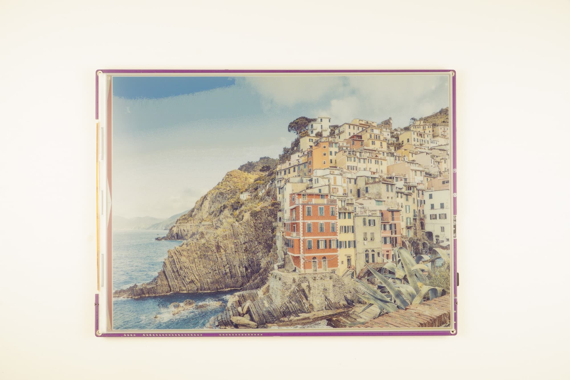

Example output displayed on e-paper display
