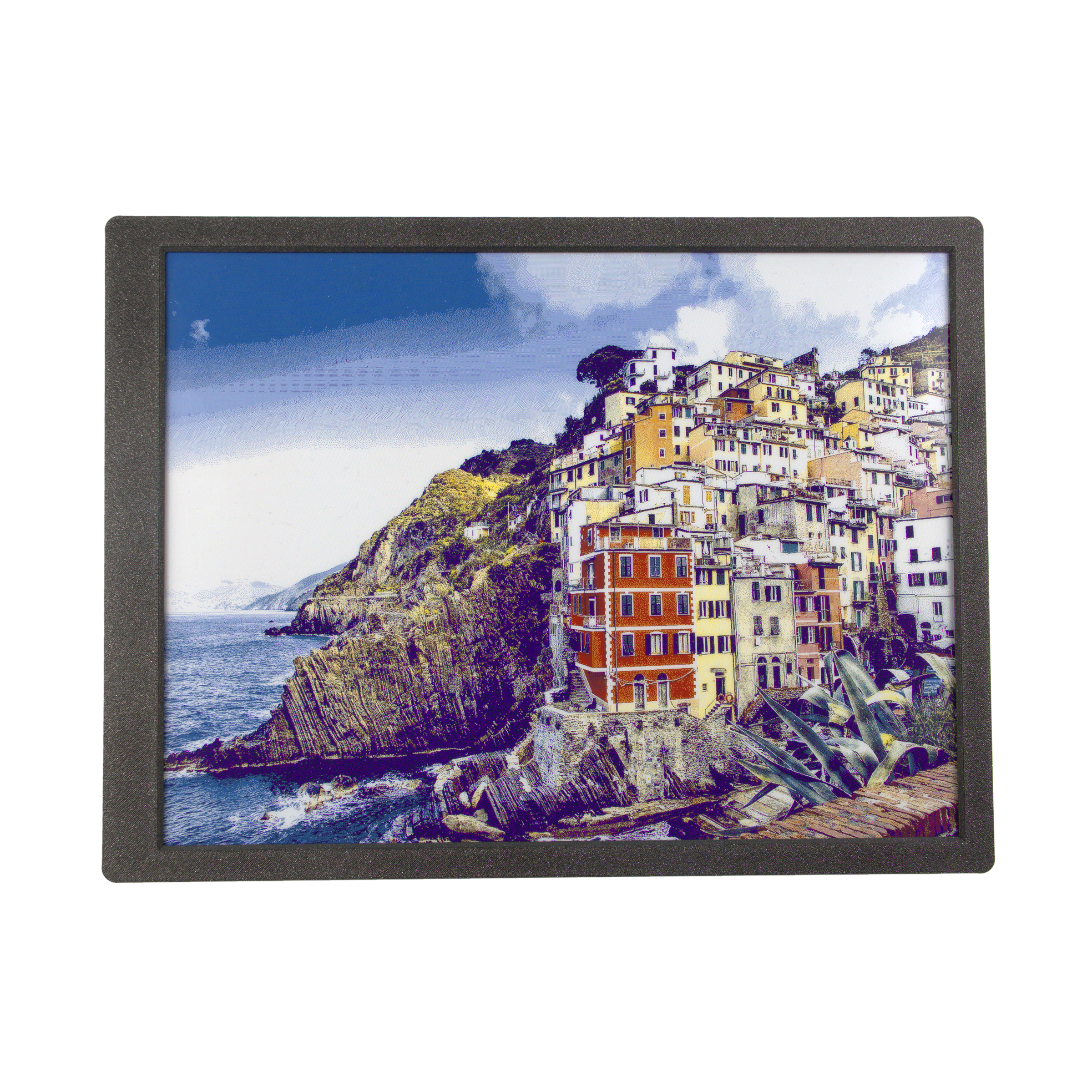

Let's draw this image on Inkplate 13SPECTRA:

// Draw the first image from web.
// This image is 1600x1200px, matching Inkplate 13SPECTRA's native resolution exactly,
// so drawing it at (0, 0) fills the entire screen.
// NOTE: Both drawImage methods allow for an optional fifth "invert" parameter. Setting this parameter to true
// will flip all colors on the image, making black white and white black. This may be necessary when exporting
// bitmaps from certain softwares. Forth parameter will dither the image.
if (!inkplate.image.draw("https://i.imgur.com/ESkX8xU.jpeg", 0, 0, true, false))

Example output displayed on e-paper display
