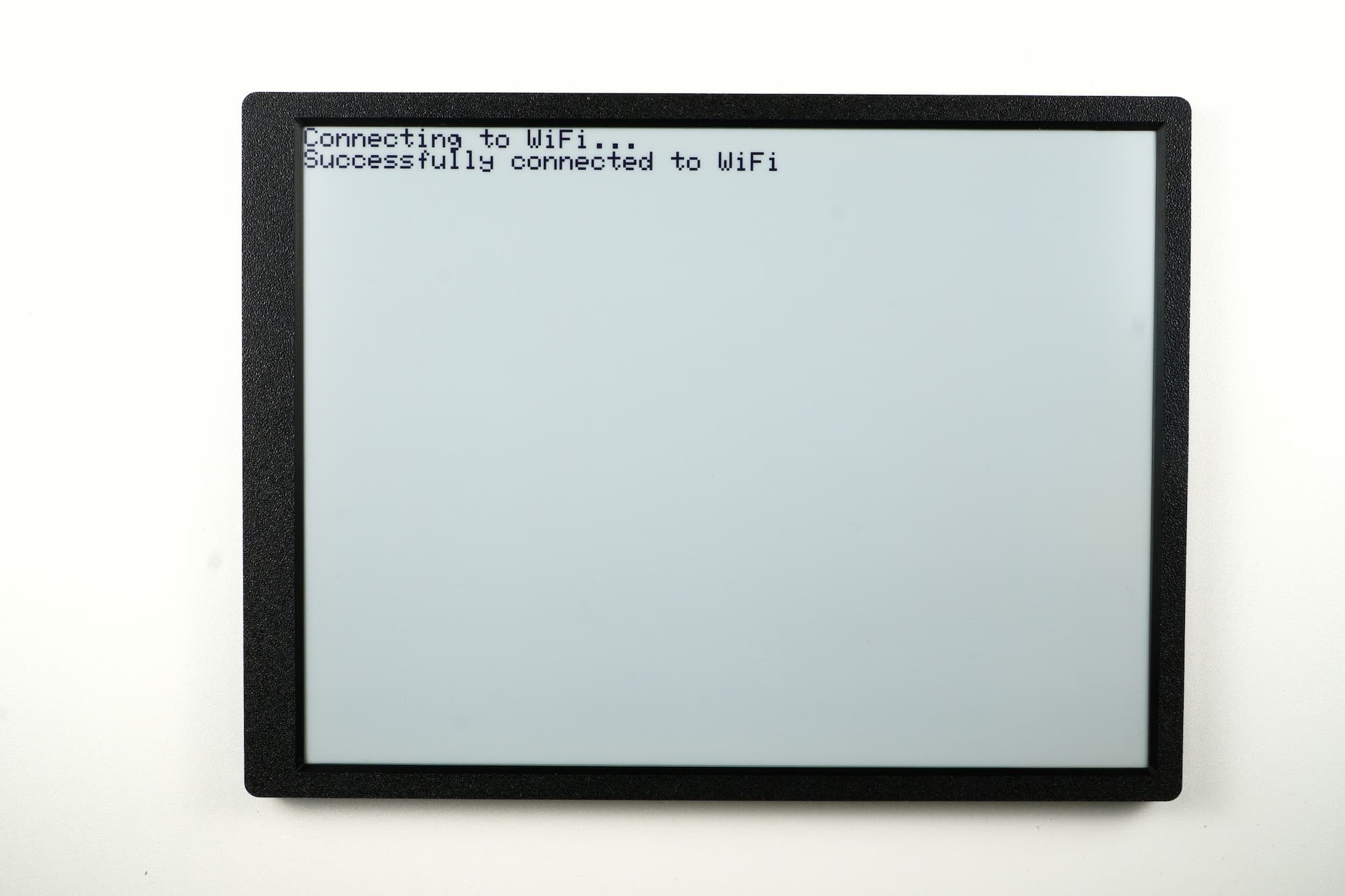

Example output displayed on e-paper display
Inkplate13SPECTRA_WiFi_Connect.ino
Full example showing how to connect the Inkplate 13SPECTRA to a WiFi network.
