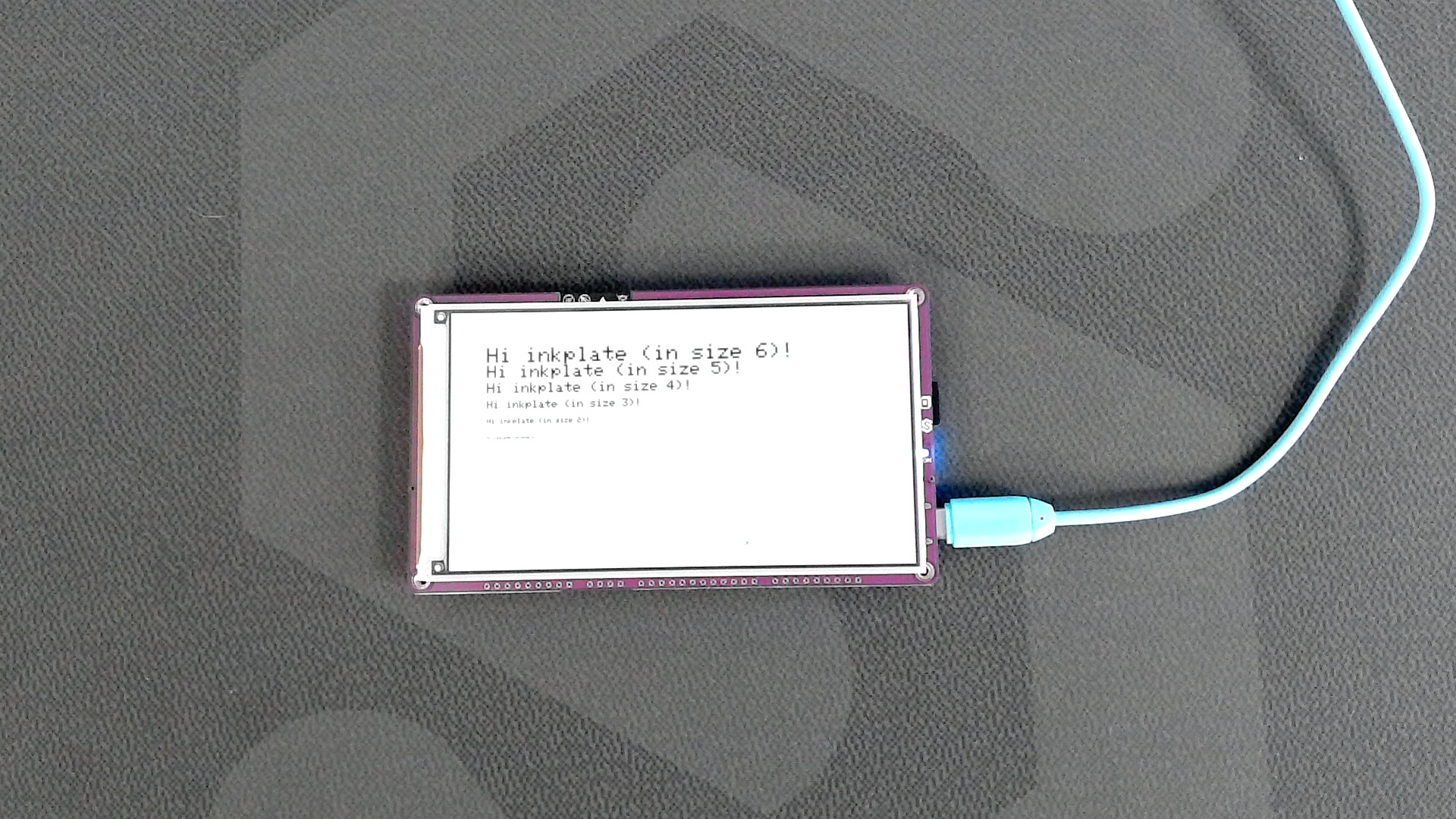

Simple text printing​
To print text, use setCursor followed by print. If you're using the default font, you may want to use setTextSize to increase the font size:
#include "Inkplate.h"
Inkplate inkplate(INKPLATE_3BIT);
void setup() {
inkplate.begin();
inkplate.clearDisplay();
inkplate.display();
inkplate.setTextColor(BLACK);
inkplate.setCursor(100,100);
inkplate.setTextSize(6);
inkplate.print("Hi inkplate (in size 6)!");
inkplate.setCursor(100,150);
inkplate.setTextSize(5);
inkplate.print("Hi inkplate (in size 5)!");
inkplate.setCursor(100,200);
inkplate.setTextSize(4);
inkplate.print("Hi inkplate (in size 4)!");
inkplate.setCursor(100,250);
inkplate.setTextSize(3);
inkplate.print("Hi inkplate (in size 3)!");
inkplate.setCursor(100,300);
inkplate.setTextSize(2);
inkplate.print("Hi inkplate (in size 2)!");
inkplate.setCursor(100,350);
inkplate.setTextSize(1);
inkplate.print("Hi inkplate (in size 1)!");
inkplate.display();

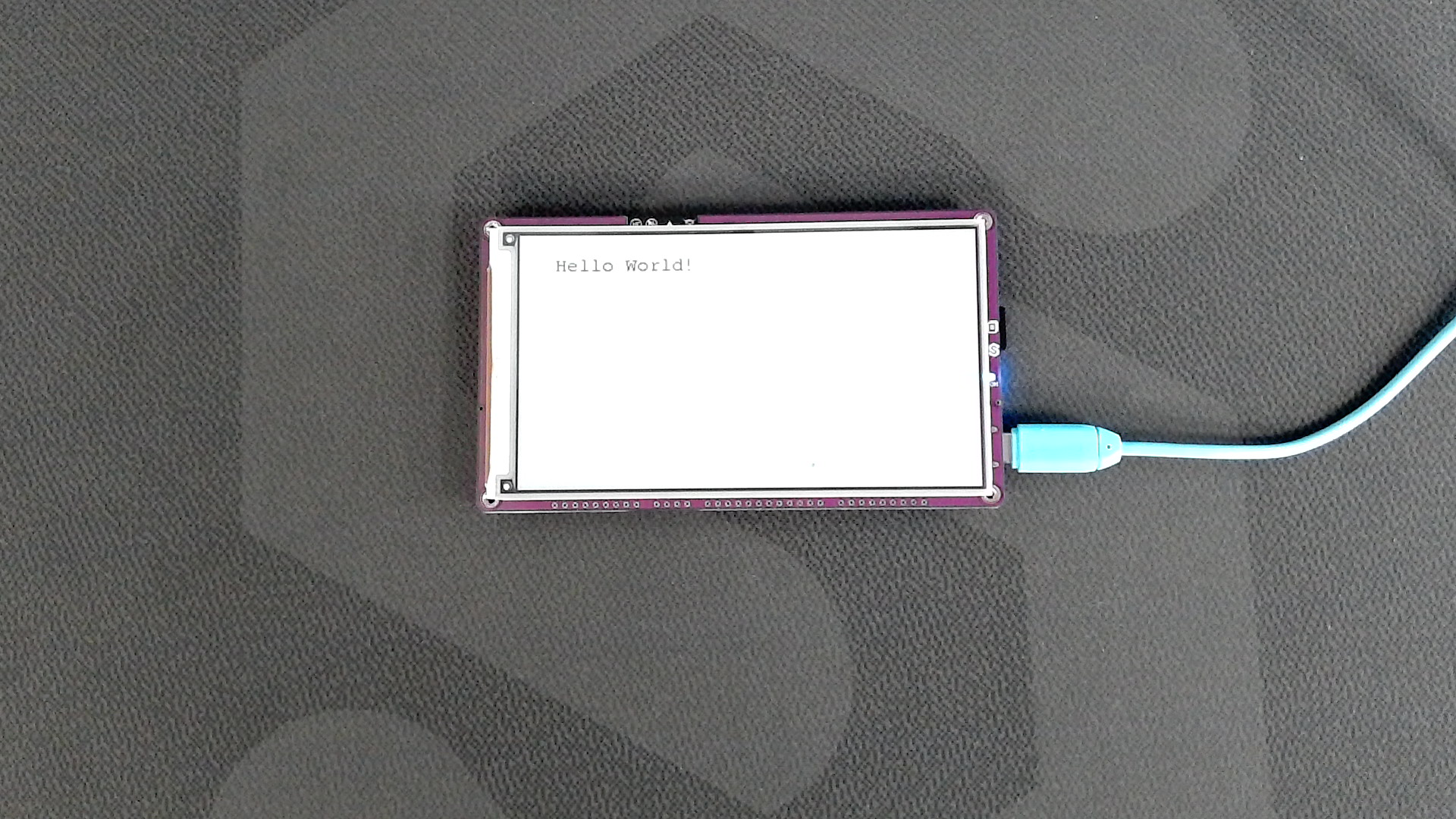

Custom fonts​
The default font looks blocky because it's optimized for minimal memory usage. For something nicer, download a custom font from the Adafruit GFX official repository. Adafruit also has examples on using custom fonts.
Once you've downloaded a font, place it in your sketch folder, include it, and use setFont:
#include "FreeMono9pt7b.h"
void setup() {
inkplate.begin();
inkplate.display();
inkplate.setFont(&FreeMono9pt7b);
inkplate.print("Hello World!");
inkplate.display();
void loop() {

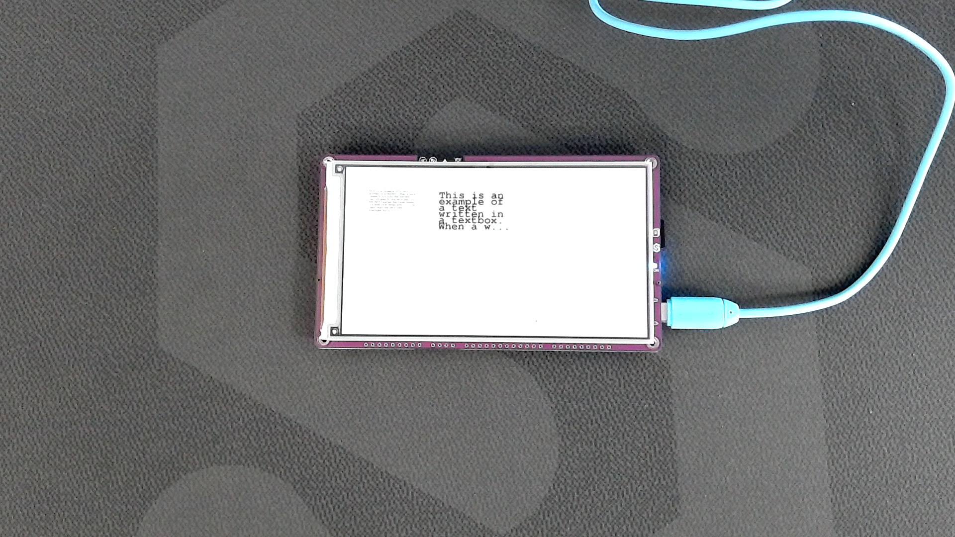

TextBox​
You can define the area in which text appears with the drawTextBox() function.
#include "Inkplate.h" // Include the Inkplate library in the sketch
#include "Roboto_Light_36.h"
Inkplate inkplate(INKPLATE_1BIT); // Create an instance of the Inkplate library and set it to 1-bit mode (BW)
// Define the text you will show in the text box
const char* text="This is an example of text written in a textbox. When a word doesn't fit into the current row, it goes to the next one."\
" If the text reaches the lower bound, it ends with three dots (...) to mark that the text isn't displayed fully";
void setup()
inkplate.begin(); // Initialize the Inkplate library (call this function only once)
inkplate.clearDisplay(); // Clear the display frame buffer
inkplate.display(); // Display the cleared image
// Create a text box without any optional parameters
// x0 - x coordinate of the upper left corner
// y0 - y coordinate of the upper left corner
// x1 - x coordinate of the bottom right corner
// y1 - y coordinate of the bottom right corner
// text - text we want to display
inkplate.drawTextBox(100,100,300,300,text);
// Create a text box with all parameters
// textSizeMultiplier - factor by which the font size is enlarged
// font - address of the selected custom font
// verticalSpacing - number of pixels between each row of text
// showBorder - create a visible rectangle around the box
// fontSize - size of the used font in pt
int offset=32; // Note: some custom fonts are drawn from bottom to top, which requires an offset. Use an offset that best suits the font you use
inkplate.drawTextBox(400,100+offset,600,300,text,1,&Roboto_Light_36,27,false,36);
// Display both text boxes
inkplate.display();
void loop()
// Nothing...
