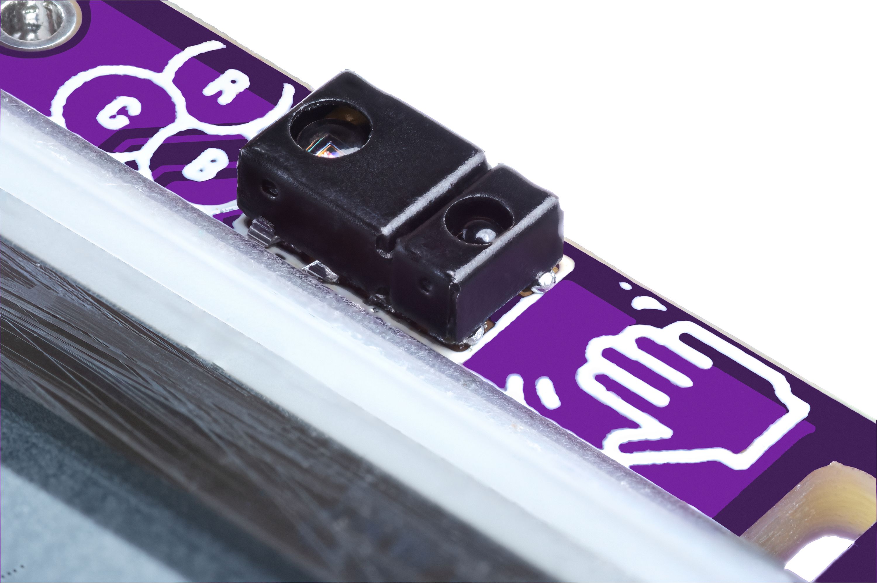

The APDS9960 sensor enables gesture recognition, proximity sensing, ambient light detection, and color sensing. It's located on the front of your Inkplate 6MOTION, at the top edge of the PCB. You can use it to navigate menus with gestures, detect whether someone is standing in front of Inkplate, or check whether the light in the room is on.
APDS9960 gesture and proximity sensor on the front of Inkplate 6MOTION
APDS9960 on the Inkplate 6MOTION
