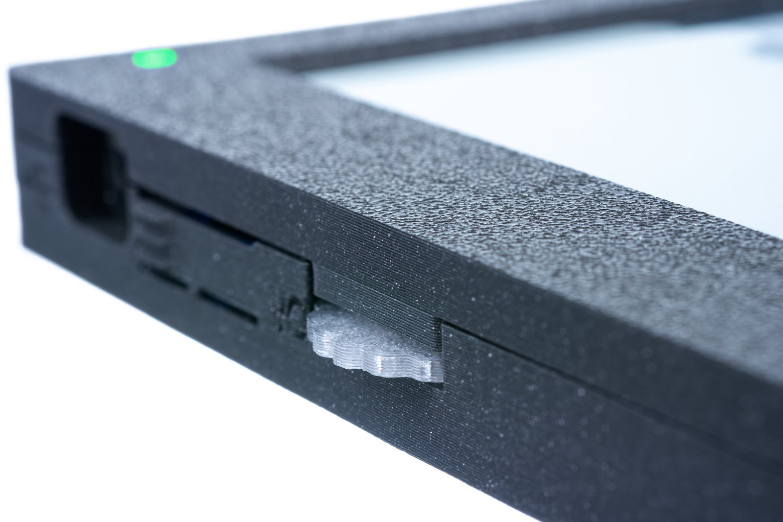

This peripheral IC is mostly relevant to you only if you have the Inkplate 6MOTION with enclosure, as it contains the perfectly placed dial with magnet to interface with the rotary encoder IC.
Inkplate 6MOTION Rotary Encoder
Rotary encoder on the Inkplate 6MOTION enclosure
The dial made to interface with the rotary encoder is transparent! It's made this way so that the first onboard RGB LED can change its color when it lights up!
